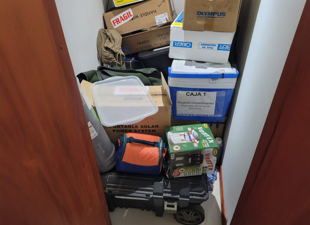

The available bandwidth was expanded with the installation of a Starlink array. These links allow comfortable bandwidth for internet and cellular connectivity in the base environment provided by the state-owned telecommunications company. But the equipment suffered other interruptions. These were due to difficulties with the care of the equipment sharing space with scientists from other areas. Some of these did not understand the value of the equipment. In addition, being in a shared area with people moving around caused it to register unwanted noise. For example, the space was recovered during the campaign from November 29 to December 13, 2023, and the equipment was reoriented. However, similar problems recurred later on.
