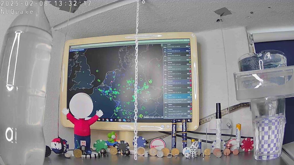

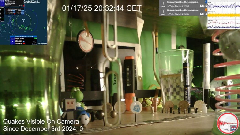

My solution to not having a Raspberry Shake seismograph was to make a QuakeCam, which could monitor seismic activity in the form of visual footage. Instead of using a seismograph, I used visual indicators. I started my first setup on December 4th, 2024, using my phone to stream to YouTube when I didn’t need it. The first displays featured simple objects like hanging coins, markers, and other household items that could visibly react to ground movement. Nothing too special.
The image above shows what the stream looked like at the time, where you can also see the GlobalQuake program on the top left. It used purely what I had available in the house, which wasn’t much… but it worked! I caught my first earthquake using this setup, even if not visible: a small M 1.9 Earthquake 82 km away. I used this initial setup for about two months before upgrading to an EZVIZ CP1 Pro security camera, which significantly improved my ability to monitor movement.
After receiving this camera, I decided to expand my setup, making more space for bigger and better QuakeCam displays. I cleared out some space on top of the closet in my room and started building with a broader range, and instead of including an overlay of GlobalQuake, I positioned a monitor in the back running the program.
As it’s possible to see in the image below, it was way larger than the previous one and contained more items ranging from homemade pendulums to poker chips.

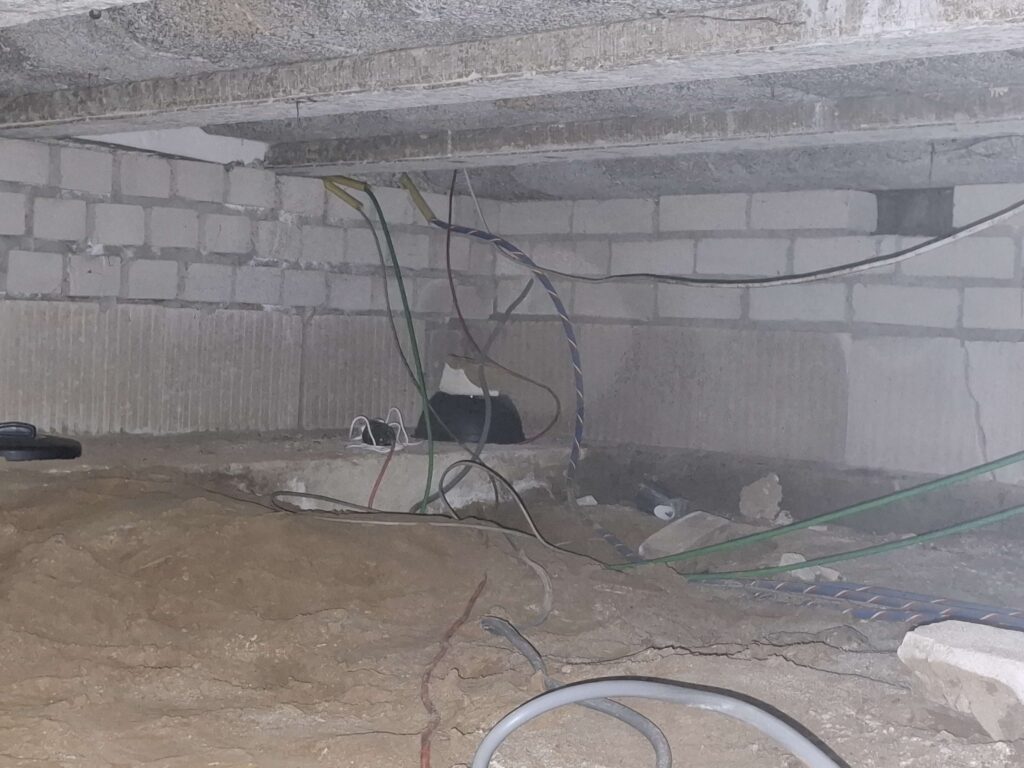

One of my main concerns was humidity, so I devised a few ideas to protect the Shake from any moisture that could build up if temperatures dropped below freezing. However, upon inspecting the crawlspace for the first time, I was shocked to find it was not humid! It was even as warm as our living room. This was a massive relief because it meant that protection didn’t have to be advanced at all.
Setting up the Shake in its first location
The next day, we figured out that we had to pass an extension cord that could lead from the crawlspace entrance to the other side of the house, which is how I could connect the power cable to the Shake.
We then carefully got the Ethernet Cable and slowly dropped it through the narrow 1.5 cm wide hole in the corner, barely enough to fit the cable through. Luckily, after a few minutes, it was done! After plugging in the Shake for the first time, I grabbed a small plastic container and put it on it before leaving the crawlspace, hoping it would work.
You can see how the setup looked in the pic above. It was a really simple installation: just plug in the two cables and wait for it to connect to the server.

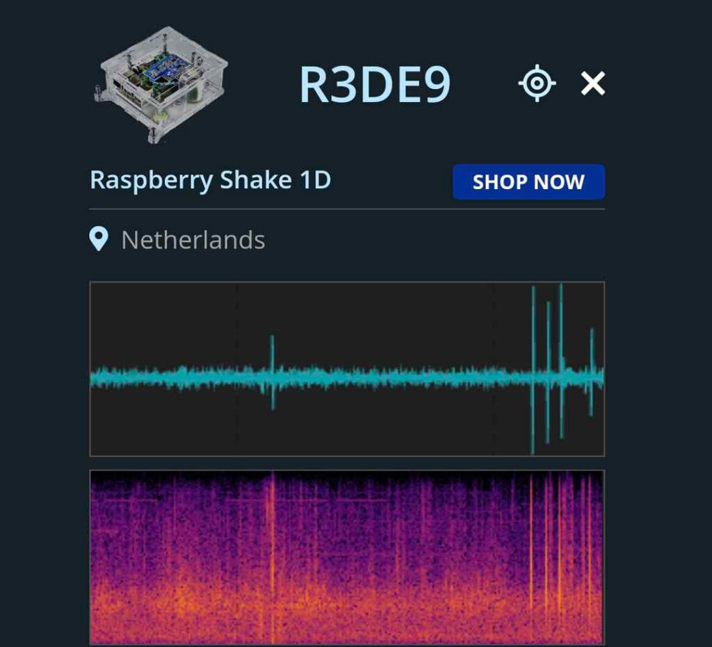

But we also noticed one slight issue. The Shake was picking up every footstep we took, making it extremely difficult to see the difference between seismic activity and human activity.
Here’s an example of what it looked like when someone took a few steps above the Shake. The spikes happened every day, only subsiding at night, which is when another problem arose.

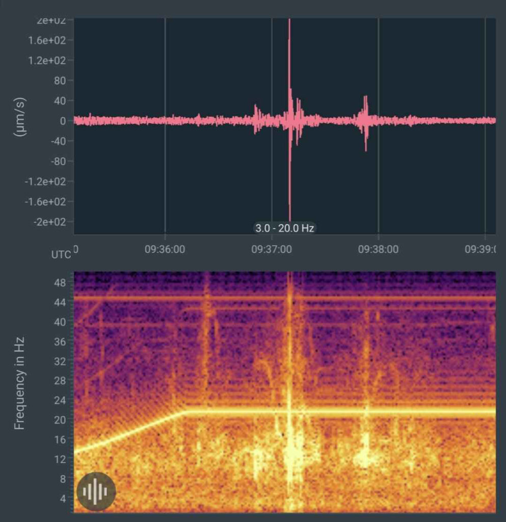

Appliances like washing machines, dryers, refrigerators, and freezers can emit low-frequency vibrations through the ground, giving you amplified data on the seismograph. On the spectrogram, these appeared as continuous orange-yellow lines. Not to mention, they could produce velocity spikes of up to 200 μm/s, higher than, for example, what an M 6.5 earthquake could generate if it were at a distance of 2000 km, or velocities caused by an M 4.0 earthquake 150 km away from my location.
This was really frustrating because my goal was to monitor and have reliable measurements from areas like the Peel Boundary Fault Zone and the faults along the Netherlands/German border.

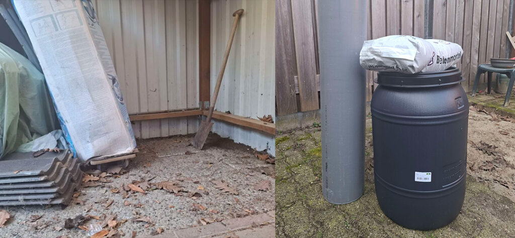

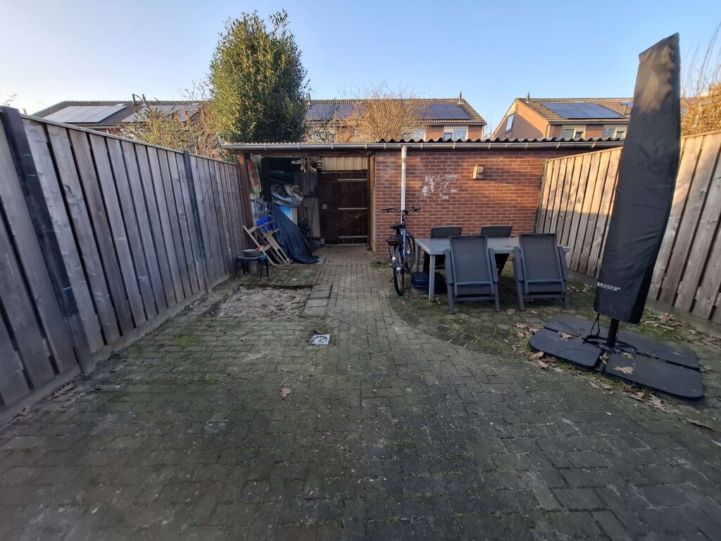

On March 6th, 2025, we started constructing an underground vault in our backyard. Since there was a limited amount of places we could build it, we decided on somewhere as far away as possible from the main building.
From this view of the backyard, you might think we would build the vault in the already prepared sandpit, but you would be wrong.
Since a roof does not cover that sandpit and is closer to the house, we instead decided to clear out an area all the way in the far back left corner. It would be a covered location as far away from the house and road as possible. I cleared a few things and moved them into the garage the same day.
The space was around 1.5 meters wide, which was good, but the tiles extended another half meter towards the left, so we had to move another few things out of the way. I took a quick break before immediately returning to it by removing the tiles from the ground using the shovel you see in the picture. It took me a few minutes, but the digging was easy and efficient. When I finished removing the tiles, I could correctly measure the distance and calculate what I would need to build the vault.
The same day, we visited a few hardware stores around the area and picked up the necessary items. The items we bought were:
  • A 60 Liter Barrel (40 cm in diameter and 61 cm in height).
  • A PVC pipe (20 cm in diameter and 1 meter in height).
  • 75 kg of concrete mortar.

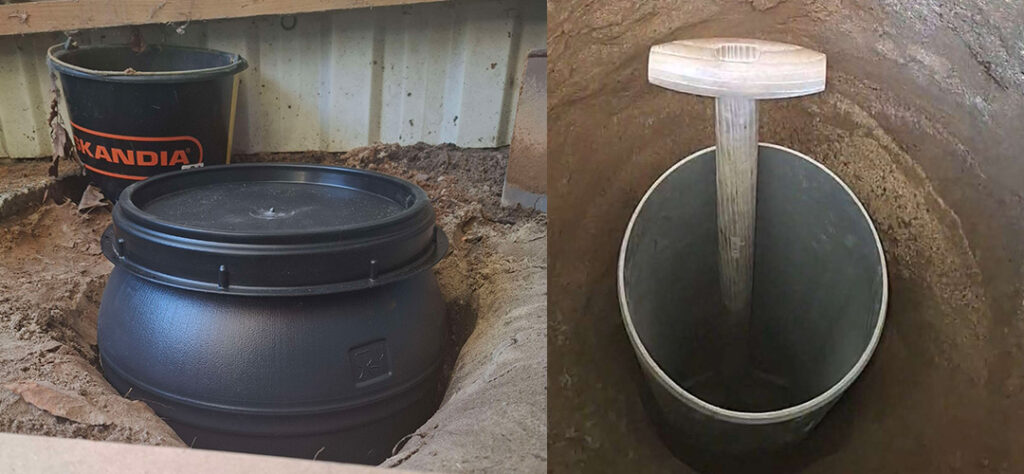

In the evening, I started digging the hole where the barrel and PVC pipe would sit. It would have to be around 55 cm deep for the barrel and another 85 cm for the PVC pipe.
Unfortunately, the only tools I had for digging were the big shovel, which I used to dig the large part of the hole for the barrel, and then a small shovel, which you can hold in one hand, that I had to use to dig the hole for the PVC pipe. Digging the hole for the barrel was easy, but reaching into a 20cm wide hole 140cm deep with a tiny gardening shovel was definitely not easy.
I had to take numerous breaks because I literally had to lean half my body into the hole even to reach the bottom, which caused me to have a bit of back pain after a while. Ouch!
After around two hours of digging, it was as good as done.

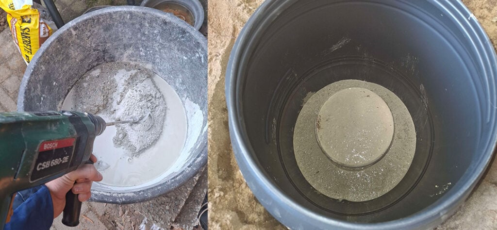

Pouring the concrete
The way we roughly calculated how much concrete mortar we needed was as follows:
Volume = π × radius² × height → π × 10² × 100 = 32L
Since one bag of 25kg of mortar would get you roughly 12L of concrete, we needed 32/12 = 2.7 bags of mortar. It’s just simple math. Thus, we bought three bags of mortar and decided to use what was left to pour inside the barrel to stabilize it.
Mixing the concrete was easy; we just poured around ¾ of the bag into a concrete mixing bucket and used a mixer to stir it with around 2L of water. We also made sure not to pour all the water or mortar instantly, as we had in mind to test out if the thickness of the resulting concrete is suitable for our purposes.
Luckily, my grandpa does a lot of construction, so getting the tools and the bucket was a piece of cake. Making the concrete took only a few minutes, and it was ready to pour.

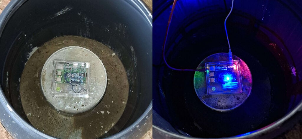

After pouring the concrete into the PVC pipe to make the pier, we cut a hole out of the barrel the size of the pipe so it would slide over it nicely. After dropping the barrel over the pier, we also filled the bottom with concrete.

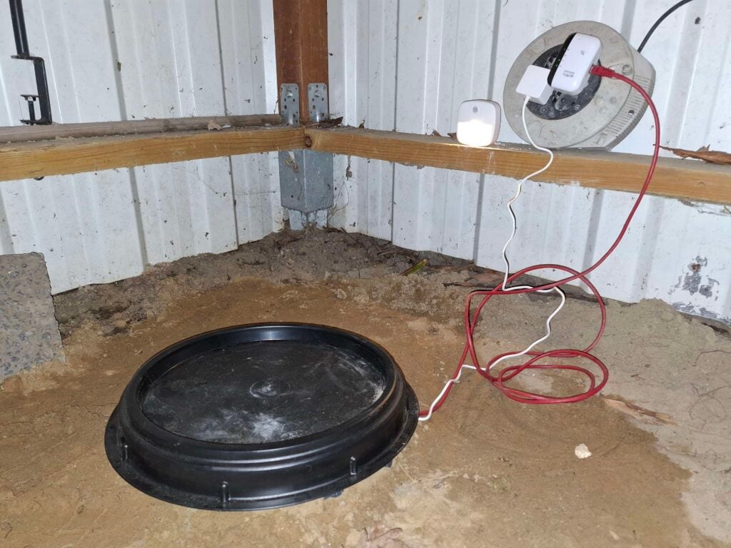

After pouring, we just had to wait 48 hours for the concrete to harden in full. Then, we would place the Raspberry Shake on top and settle it into its permanent home.

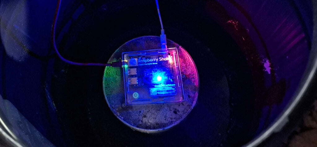

For the first night, we plugged in the Raspberry Shake and had it sit loosely on the pier since we didn’t yet have the tools to screw it into the concrete that came the next day.
We then borrowed a concrete drill from my grandpa and settled the Shake down. Drilling in the right places was much more complex than anticipated since the concrete was so hard the drill could barely get through, but it just worked out. After securing the Raspberry Shake in its place, we plugged it back in again, put the screw lid back on and left it there for another day to see if it would work as we hoped.
The next day we checked the vault and, although a bit of condensation built up around the sides of the barrel, the Shake was fine. A simple fix to that was to put a bag of silica balls next to it to absorb all the moisture that might build up over time.

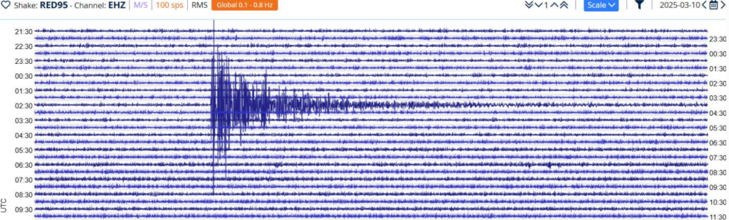

The day before I got the Raspberry Shake, the biggest earthquake in around 1.5 years hit the Netherlands, and the day after I unplugged it to undergo construction, a magnitude 6.5 earthquake hit 2200 km north of my location, which was caught clearly by another Shake a few kilometres away from me.
However, my Raspberry Shake has now been useful in catching two local earthquakes which happened on a fault, the Viersen Fault, which has been inactive for the past fourteen years. Although small, they were clearly visible since the distance between the quakes and my Raspberry Shake was only 30 km. Not to mention the recent 7.7 earthquake in Myanmar which was also visible.
